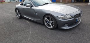

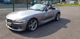

I've just fitted B8's with lowered Eibach springs to replace my Msport setup. I believe this is sold as the B12 kit by bilstein? The car feels completely different now, yes it's firmer and lower, but feels tight and planted. I also poly bushed the lollipops and front arb at the same time. I did notice when fitting that the Eibach springs were a fair bit easier to compress by hand than my old ones which worried me, but apparently their variable rate means they are supposed to be like that.
Going in for alignment in the morning, but more than happy with it.
Also looks quite mean lowered. I'd say it's dropped about another 20mm over M Sport, so about 50mm over SE. Have to say that parked next to the 3 SE cars I have in at the moment it looks slammed :D
Here it is on M Sport...
And Bilstein/Eibach combo
Still running 15mm spacers on fronts and not had any rubbing..
