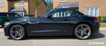

Before and after shots of mine (I did spend £4 a corner on new wheel bolts and £1 on new centre caps from eBay):

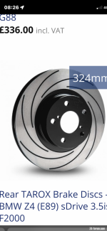

All E89s apart from 35i in Europe and 35is have same size rear disc n caliper

I am a real cheapskate, so did them for the least financial outlay I could. They still look as good a year on. :thumbsup:

Just a warning if you have a 35i and are looking overseas for the brake calipers/discs: the 35i in the UK has the same size brake discs and pads as the 35iS as standard.
The 35i in America has the same size discs/pads as the 28i over here, as I found out when my StopTech Street pads wouldn't fit :(
