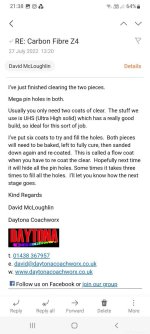

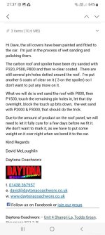

Yeah 12 coats but I think they sanded it right back after the first 6 coats . Too technical for me , but something about a lots of pin holes .
Definitely gives it depth . Looked abit plastic before
