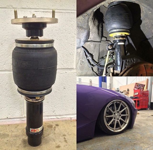

I can't comment on Spring ratings because I've got bags on mine instead of springs and I haven't a clue what springs came with mine
