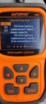

I've just plugged my Autophix in to get pics as Im selling it now the car is going.. got a shot of the relevant screen mate
Nice one, thank you kind sir. I will have another look tomorrow, looks like I have not scrolled down or something when needed 👍
OK so I tried again many times. I am still unable to find a screen to enter the power of the new battery. The images are the wrong way round, but if I select the option to register a battery of different voltage it just jumps to the screen saying it’s been successfully registered…if I then press ok to “carry out the following” it just jumps to the “service function complete” screen which is a dead end
Surely it’s not as difficult as I am making it??
Hi EZ, Having pressed up, down, left, right… it gave me this extra line. Which is an option I don’t recognise from the other menus available?

I am hoping that last screen might jog Mr Tourette’s memory and he may come back with a suggestion. Still should be no problem starting the car at present, it probably thinks it’s got about 26 batteries to work with :rofl:
Hey Bbb, not sure where this rabbit hole goes as I replaced like for like but remembered seeing the option.. However on your pics it does state.. to register the new size now go to retrofit diagnostic tools.. battery
That suggests you go to another menu in the scanner.. diagnostic tools? Unfortunately I packed off my scanner today to the buyer so am unable to look at the menus
