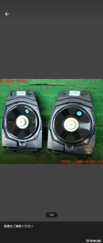

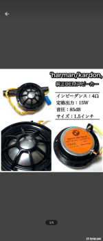

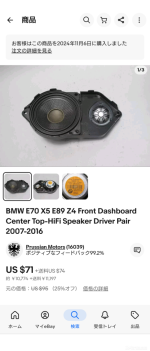

I bought a 676 Hi-Fi amplifier second-hand, changed the center speaker and door speaker to Harman Kardon, and installed Twitter, the rear subwoofer was difficult, but when I installed it, the bass song is irresistible, please note that the standard speaker wire, power supply, and connector are different, and the subwoofer, I wired the center speaker from the amplifier to the speaker myself
If you don't spend money, you do everything yourself

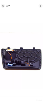

It's easy to twitter on the door, you can get a sense of realism with high notes. The hard part is that it's hard to drill holes in the rear subwoofer, and I don't want to drill hundreds of small holes anymore because I don't have any tools
The Herman Kardon logo was pasted on the Twitter net

I bought some horn speaker covers and bonded them in to the holes I cut out in the back panel.
