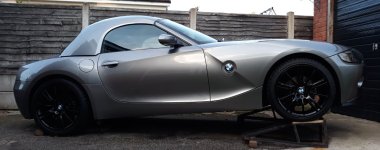

No. You need to get access underneath to undo the left side engine mount bolt and jack the engine up. Also you need to remove the under-shield from the engine bay so that you can drain the coolant. I have mine up on wheel ramps. 20181112_153408.jpg
