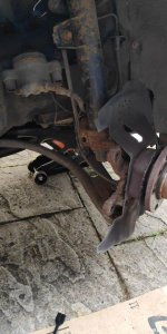

Over the weekend I commited to spend a LOT on the car:
  • So started taking appart the entire front suspension to replace brake calipers and hoses
  • While in there I will do bushes (so ordered a full kit of Stronglfex polybushes, will do the rear later once I recover :D )
  • Messed up and damaged the boot from a drop link so ordered a set of two (funny how you can manage to not have a 16mm spanner despite have a total of 3 sets of them...)
  • Managed to get the steering links out of the uprights but not the upright off from the controls arms, seems like I need to modify my tool with the angle grinder a bit though might take out the uprights with the control arms and separate them offboard
  • Realised the brake shields are pretty crusty so will try to do a fix with shims
  • Removed all undertray in preparation of taking out control arms
  • Removed front grills to fix my lost front badge and while in there will remove the strut to paint it with the same paint as the calipers
  • As all that was not enough and I was stuck while waiting for additional tools to show up for the rest of dissassembly I took out my hood latches off to clean and grease them

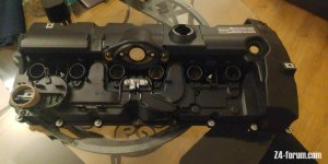

I also have a new valve cover and eccentric sensor ready to go but obviously calipers replacement took priority. I cannot thank enough the trusty 1/2" air impact :thumbsup:
I am pretty much £800 in right now including all parts and some tools and stuff scattered all across the garage :o :?
