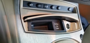

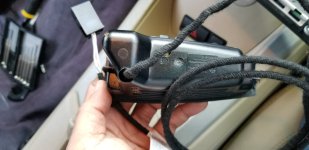

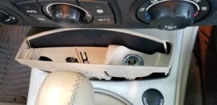

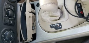

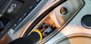

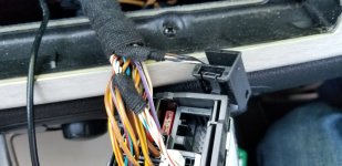

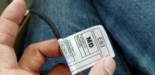

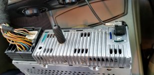

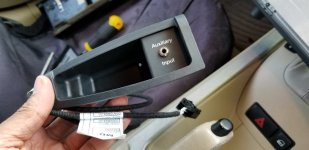

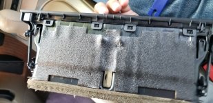

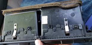

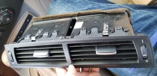

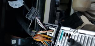

S skurup Member May 26, 2018 #1 Hi all, Posting the procedure to install the aux radio input for the E85/83 models. I hope it's helpful to at least some of you out there.
S skurup Member May 26, 2018 #2 View attachment 8attachment] Attachments 10.jpg 85.8 KB · Views: 973 11.jpg 121.2 KB · Views: 973

P ph001 Veteran N. Yorkshire. Jun 4, 2018 #6 Great pics. The only problem with having it there is you have to have your ashtray open while its in use. The oem position is under the dash which avoids the problem.
Mr Tidy Moderator North West Surrey Staff member Site Supporter Jun 4, 2018 #7 Brilliant write up OP, and a really OEM looking installation. Shame I won't be able to use it though because someone has already fitted it (with the input in the glovebox).

K kis Veteran Surrey / West Sussex Boarder Jun 4, 2018 #8 Like this setup. I’d need the ash tray open for the usb charging through the cigarette port anyway. Nice pics OP!
