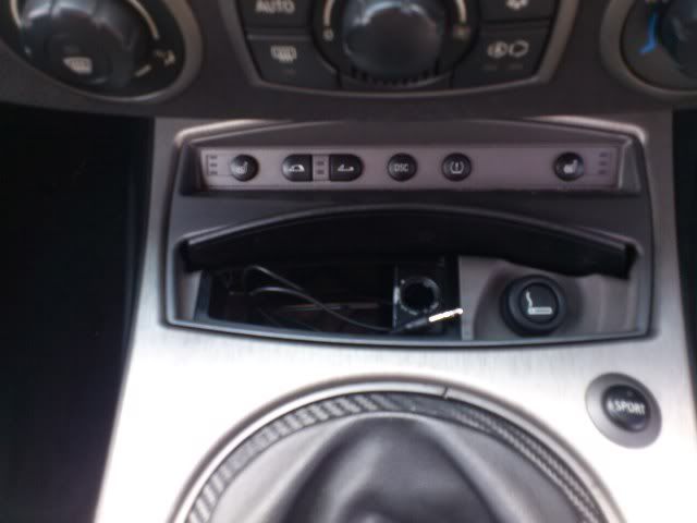

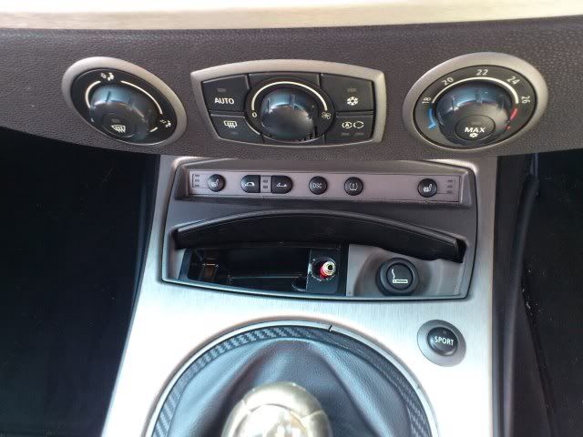

well mine came yesterday and i fitted it today.
seriously easy mod :lol: hardest part was getting the airvent's out.
the previous owner had already butchered them (and part of the brushed alu trim around them) so i didn't need to be careful. can't get them all the way back in now though :roll:
ended up routing it through to the ashtray as i didn't want to drill the plastic panel
and then hid the jack after i dug out my aux lead
works perfect :thumbsup: big thanks to the guy who suggested it!

Is it literally just a case of plugging it into the HU, feeding the wire somewhere decent and slamming it into your iPod?!
I've got to do this then... Id like mine in the glove compartment like I did my last car, is this possible on the z4 do you think?
it isn't amazing quality but good enough if you just want to listen to some tunes without bass, as it has almost none :lol:
