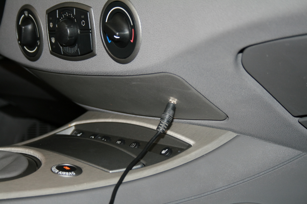

Installed the Aux input in FnI's car yesterday, it is only a 30 minute job at the most, depending on how you want to go about it. I prefer to recommend the Aux input cable made for the MINI Cooper, half the price of the "BMW" version, and it can be mounted anywhere you like. Here is a pic of the final assembly:
The cord hanging down is the interconnect cable from my MP3 player, all that is actually visible of the Aux input cable, is the small round jack mounted on the panel. :thumbsup:
