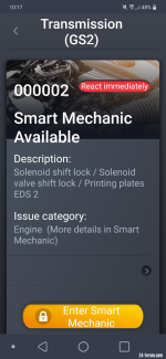

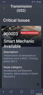

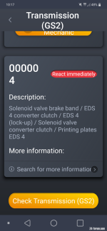

I have Carly,
This is what it reports in the attached pics

I agree with the Carly comment. Every time I see faults from it they are impossible to work out.
In this case you seem to have a multitude of issues, which possibly all pass through that one switch.
