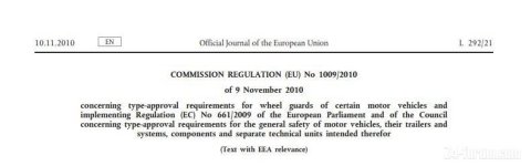

Z4C_er said:So, according to the law, yes, they are illegal. OEMs must adhere to strict requirements regarding wheel coverage:
This is EU law, and is applied to all vehicles being designed and to be driven on EU roads. This law, AFAIK, is applicable universally.Darkangelv2 said:Z4C_er said:So, according to the law, yes, they are illegal. OEMs must adhere to strict requirements regarding wheel coverage:
Where did this law come from? Often is the case that the legal requirements of manufacturing/selling are different to road worthiness laws that apply to us muggles!
