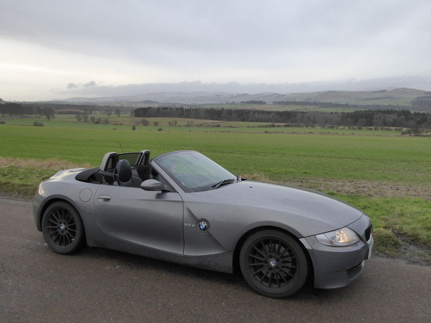

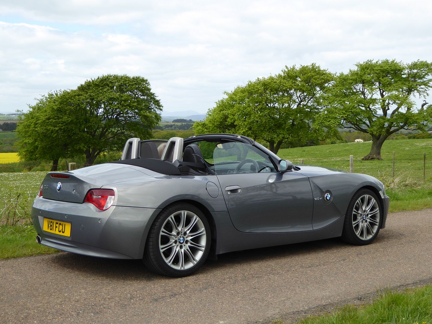

I have style 32 wheels (if that's what they are called) in 18 inch. Even with ///M fitment winter tyres (higher sidewall front and rear staggered fitment) they weighed a total of 27kg lighter than my Original Fitment wheels. They feel appreciably lighter when you pick them up.
Originals fitment
Winter wheels - (now summer fitment) at least 27kg lighter in total.
This may be a cheaper way forward if you can live with the dated design and they come in 17in?
The ///M fitment tyres DID make a difference to the ride with just an increase from 35 to 40 at the rear and 45 from 40 on the fronts (sidewall height). I bought 3.0si fitment in the end however to save £100 in tyre costs and I can live with the ride as is. I weighrd each wheel and tyre against the original fitment and found them an average of 7kg lighter each.
