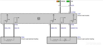

I need to know which plug is which for the heated seat connections.
Any clever soul know ? I have lost the heating on the bottom part of the driver seat but the sides and back work.
I've swapped the control modules And they both work on the passenger seat.
Here you go 2

Bit weird really. Doesn't show any issues but the bottom of the seat doesn't heat.

Well, I found an old seat bottom at a scrappy. Plugged it in and it works so somewhere inside mine it's come disconnected or a broken wire somehow. Strange how the side thigh bits still get hot though
