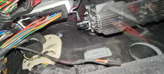

O Optinium Member Warrington Sep 27, 2021 #1 Found loose behind the glovebox without anything to visibly plug in to.
U Umfaan Senior member Miskin , South Wales Sep 27, 2021 #4 Just check as have Dash board out and only likely plug would be the air bag….
U Umfaan Senior member Miskin , South Wales Sep 27, 2021 #5 The other 2 wire plug is the under dash light
O Optinium Member Warrington Sep 27, 2021 #7 Thanks for the suggestions, I found what it was, looks air con/heater related, ill post an image/info later as to what it was
Rockhopper Senior member Mansfield Site Supporter Sep 27, 2021 #9 Airbag and SRS wires tend to be yellow.
O Optinium Member Warrington Sep 27, 2021 #10 So from what I can make out it was an actuator for directing the air flow to the cabin. Must have come loose when I originally removed the GM base unit. All back in now. Thanks again people for the suggestions etc...
