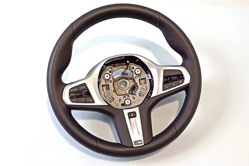

Hi, have you done this on a g29 z4?
One of my friends is looking for a Z4 and the odd one is without the heated function which would be nice to have and from what I have seen it's a simple retrofit as the steering wheel has the wiring and button already fitted as in the below link:
I have bimmercode to enable the heating function.
From your experience is there anything else I need to change? I.e. slip ring
Many thanks for any help.
Im sorry but no I've not done it to a G29. Totally different coding process, not even sure it can be done.
