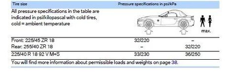

Yeah, the standard fronts on 18" alloys are 225/40/18, not 225/45/18.

Unless you're going to change your wheels then you'll need to stick with more or less the size that you've got (are you sure the fronts are right as you've listed the same profile and width as I have fitted to 17" rims?!), but you'll notice a massive difference even keeping the 18's if you swap to winter rubber. If you've got 4 minutes to spare then check this reasonably scientific test out which uses a 3 Series:-

If you are buying another set of rims, then dropping a size to 17" would probably be a bit more cost effective but they are the same width (225/45/17) as your front tyres. When I was looking I found that winter tyres to fit the Z4 16" rims were hardly any cheaper than 17" so makes them a bit pointless and I'm convinced that the 17" wheels are going to offer suitable grip.
If you have somewhere to keep them then my recommendation would definitely be a separate set of winter wheels and tyres, but if not, and the Z4 is your only car then changing just the tyres will still see that-

Forgive my ignorance - but run 225 tyres on 255 rims? Can't imagine the insurers will go much on that idea. More info please.
Some 225 tyres will fit 9inch wide rims, but not all tyre manufacturers specify min to max rim size allowed for each tyre, not on their websites anyway, so the information is not always easy to find.
I seem to recall lower profile tyres fit a wider range of rim widths but not sure if this is actually true, so a 225*40 could be okay on a 9inch wide rim. You'd have to check with the tyre manufacturers.
I once fitted 225*16*45 on a 9inch wide rim (that originally had 245's on). Looked okay too, rim wasn't that much more exposed although I made sure I selected a tyre with good rim protection.
Of course fitting a lower profile tyre will make the car look more agricultural though.
The manual for the M states that snow chains should only be fitted to the rear wheels if 225*40*18 conti's fitted I think, so that would mean that tyre would be okay on the 9 inch wide rim
Darren M, thanks for that - but rears are 9.5's. Still applies?

DUnno, would have to check with the tyre manufactures. Think a 225 tyre on a 9.5 inch rim might be a bit much
Most manufacturers recommend running the same width front and rear even if normally they would be staggered. My SLK used to run 225/45 and 245/40 but on winter tyres it was running 225/45 all round.
BMW recommends 225/40 18 for winter tyres - this is in the ///M supplementary manual.
Remember that 9 inches is only 229mm so a 225 wide tyre isn't that far off. I have found before a range of min-max wheel/tyre widths, am looking for it again now.
Edit - your rears are only 8.5 inches too, if you're thniking about using your original wheels.
