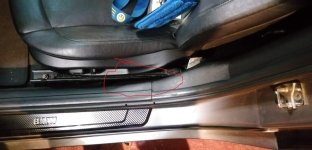

anybody got one of these ??
passenger side to the left of the rear of the seat buried under the carpet seat bolted to the chassis interior under the carpets
just spoken to bmw who quote 322 quid for part number 65 77 6974366 as a replacement for my 65 77 6962887

Evening,
I’ve taken the passenger side carpet out but can’t see any air bag module,
There is one between the rear of the seats, just behind the hand brake leaver.
Is that a different one?
There's one of these modules either side, as you say under the carpets on the sill wall in the rear footwell, they are impact detecting devices connected by cables and fibre optics to the unit under the centre trim behind the handbrake. In the event of one of these detecting side impact the relevant airbag is deployed.
They are coded to the chassis of the car and from personal experience cannot be directly replaced as they show airbag fault and dash airbag fault light will not extinguish unless programmed to the car correctly. But be warned this is not always possible, having exactly the right part number and even by sending to a very good auto electricians. If anyone has a better experience than this please let me know as mine still won't programme to the car
You need to code it to the car in terms of VIN (using NCSExpert) and then the mileage and time sync (using ISTAS-P, note ISTA-P won't work). Proper pain in the arse getting all that lot working through a virtual machine.
