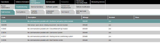

Righto then, remembered I had ISTA+ and INPA installed on an old laptop from from E92 and Mini R56 days of the past so did some updating of files and got the E89 scanned, results below - seems to be one of the two right hand Hall Sensors in the boot which which should be easy enough as a first port of call to fix, will order some new salmon relays as preventative measure and see what happens.
No idea what the other ones are for the Fuel Pump error would not clear even after a module reset, the Car Access one has me stumped.

Usually takes a while to work out which codes are 2nd order phantom consequences of real faults .

Pretty sure that this is the wrong direction!
If so many ECUs (CAS, CTM, Roof Function Center, Clima,..) don't respond to ISTA, that has to be solved at first. A NEW battery should be the next logical step, if it's elder than 5-8 years.

but if communication with so many control units is lacking, then roof wisdom isn't necessary. :ROFLMAO:
Currently, I see no starting point based on these codes, except that there might be a problem with the older ISTA configuration - or even a dead battery.
A new i.e. Varta 70Ah AGM is required. Don't forget to register it with ISTA.
