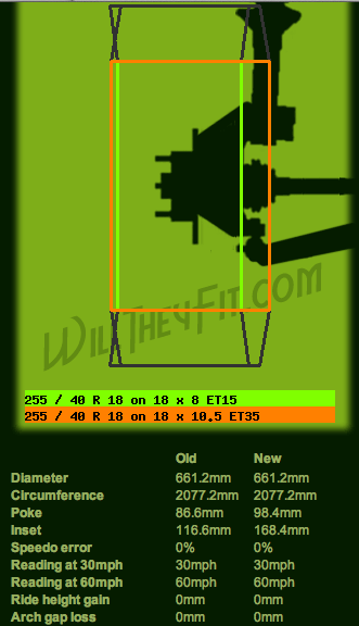

coenZ4 said:
With the final calculations it would do this with Marius's setup
not so extreme...right?
Don't forget , there is no shock in the back ;) you have mich more room to play on the inside
Send from my Android using Tapatalk 2
aggressive or not.. but the 9.5+31 are probably going to fit perfectly!! :)
with this coilover setup they will poke 16mm (to this wheel) and have 2mm room to the shock! I am happy because I am not even runnen REAL agressive Camber :)
