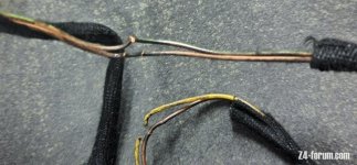

Regarding the age of the car I'd expect broken wires in the roof shell in the upper not visible area.

I would reach back over your right shoulder in the right seat.
You can see exposed wires in the roof, try jiggling those.
Breaks i have had wires break in that area.
If wires reconnect, the bong will stop.
Will come and go if you waggle the wires.
This picture with cabin roof trim removed.
