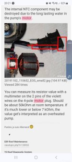

So, I may be nearer to understanding why my roof is playing up. By using Bimmerlink, I see a roof error A6A3 temperature sensor. Doing some reading, it seems this is caused by moisture- which makes some sense as my boot does leak (I've ordered new vents) and the foam carrier for motor is usually damp. I believe the sensor is located inside the motor - can anybody confirm or deny this? Can the sensor be recovered/ repaired/ replaced?

I've just done this check and I'm getting 51.2kohms... so hopefully all is well.
