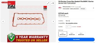

I bought this a while ago... only opened this week to fit but find this inside... wrong part? or have i ordered wrong.
original advert and confirmation of fitting. Should of searched with the oem number?

If your engine is black cover- it’s a thin rubber gasket
If it’s the silver top it’s a coloured (usually terracotta, sometimes green) metal gasket

I always use very small dabs of the stuff used on the half moons on an m54 to hold it in place
But the metal ones are much easier

It's a silver top. I have a terra cotta on the car which I always presumed was not metal as it gives the impression of being of thicker material judging by the exposed edges that can be seen..
The green one supplied is very thin...
intrigued to know why two colours though!! ... the terracotta gives a great 'pre warning' that it is leaking visually... the green would not.
If the consensus green is good to go.. I'll proceed.
