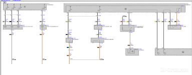

Their problem was caused by damp/corrosion shorting out the boot release and brake light circuits. I physically traced the boot lid wiring and there behind the trim, next to the offside rear light was the blue 18 pin connector referred to in the thread. I attach photographs showing the location of the connector, the internal corrosion and wiring diagram. Connector is X14303 and the boot release wire is GR/GE on pin 17. To access this connector follow the same process of removing trim as you would for removing rear light cluster or for that matter same initial process used when installing a Smart Top Module. Both are well documented on the Forum and it literally takes 5 minutes to remove the 3 pieces of trim – very easy with roof in half up position. The connector itself is easily parted by depressing the tab and swinging the locking arm down.

A final thought. Connector block X14303 is poorly protected from moisture in the position it is mounted and I know from that earlier thread that I’m not alone with suffering corrosion on it’s contacts. It’s easily accessed and I think a quick check on it might well be worthwhile preventive maintenance as it can affect several circuits.
