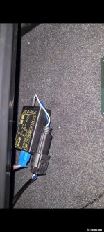

Whilst looking under the passenger seat I found this strange box. Is it oem? Anyone know what it does?

I believe the strange box is an occupancy sensor bypass, fitted when non-compatible seats are installed. (I am no expert on this though tbh)
So yes, get the codes and report back. Maybe they have pushed the seats right back and messed up a connection somewhere?
