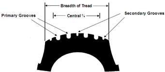

If so, I think the dealer is pulling your pants down, as the MOT only checks the centre 3/4 of the tread - the shoulders are not part of the 'central' tread for these purposes...and can be bald for all intents and purposes.
I'd check the depth in each of the circumferential grooves to see what the real figure is.

The yellow marks were so that they could easily find the places with the cuts for showing on video. The most wear was inline with both the cuts, you’re right this isn’t in the central 3/4. However the two cuts were down to the cords making it a fail.
