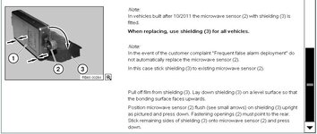

What does the foil actually do? Doesn't look particularly hi-tech :o
The tech today said that it reduces sensativity! It would be nice to have a definative answer tho!
I'm amazed that an organisation such as BMW can have such a low tech solution to a problem.
In case anyone needs this info in the future... Looks like a small metallic sticker is used to cure the false triggering issue.
