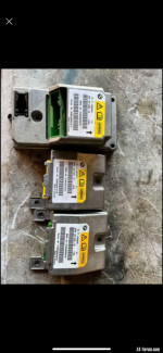

Attached picture of airbag mounted behind passenger door. In case it helps.

The fault is with the Satellite Module not the actual airbag in the door, the Satellite module lives behind the lower side trim just behind the passenger seat, remove the door threshold trim and spring the side panel trim away so you can see the module, held in by two bolts. Disconnect the battery before unplugging it if you are removing it.
Faults with this module are usually down to water ingress often caused by the roof motor cavity drain being blocked and filling with water that overflows and runs down covering the module. Drying out won't restore it, you could try programming it again using software but odds on it will require replacement with a used module with the same part number or one that is exchangable with your current one. Check Realoem parts site, it will list wehat modules are exchangable with yours.
Replacement will require coding to your car as it needs your Vin number coded into it so it can spak to other modules. Coding can be done with NCS Expert, DIS and Winkpf BMW software, higher end diagnostics Tablets like Autel and Launch can also code modules but they do cost a lot more than setting up an INPA package that includes NCS Expert DIS and Winkpf on a Laptop.

I can give it a go at coding a replacement going to be away 5th March to 29th March on a trip Down Under so that gives you time to source a replacement used module. Word of warning it can be a bit of a lottery getting a working module some come from crashed cars and are locked up which prevents successful coding source one that comes from a car with no airbag light and it should be good to code.
