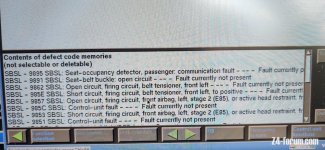

The car is a 2003 e85 3.0i with M-Sport heated leather seat fitted by the previous owner. The airbag light came on around 2 years after I bought it. Today I decided to work out what the fault is.
INPA tells me there is no fault but DIS is more specific and has told me that the 9895 SBSL is currently present which is 'seat occupancy detector, passenger, communication fault'.
I took the seat out today and found that the occupancy sensor looks like it already has bypass modification fitted by the previous owner. So would this fault be the bypass or the occupancy sensor becoming faulty during my ownership?
I'd like to order the correct part to get it sorted and then clear the fault in DIS so I can pass my MOT next week 👍🏼

Good chance that bypass unit has failed. It is a resistor that reports back to the airbag module, if that sees the expected resistance it passes the test and if all is well with the rest of the system components the dash light remains off. Once the fault is fixed the code will need to be deleted with a scanner and the light should go off.
