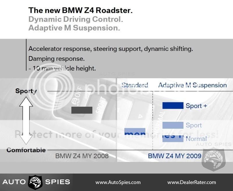

This might help... and is the primary reason I wanted a car with it;
I'm not sure where non-adaptive M Sport suspension sits in the graph, as I didn't try E89 with adaptive suspension.
I can confirm that on standard the suspension is set up for comfort and is considerably easier on the fillings than the older model. On sport it firms up a couple of notches but more evident is the sharper steering and throttle. On sport +. It's as hard as the old model and even a little twitchy in a good way :evil:

Having also just driven a 20i M Sport, I'd say it was stiffer but not uncomfortable, than my Normal (adaptive) mode. So if its a choice of comfort and choice, go with adaptive, but if you don't go with adaptive I don't think you'd know/miss it.
How did M-Sport suspension compare to your adaptive suspension on Sport setting?

I'd say the 20i M Sport was a smudge harder than my Normal mode, but a smudge softer than my Sport mode.. You don't even want to know what Sport + feels like... lets just say the road has to be very good!
