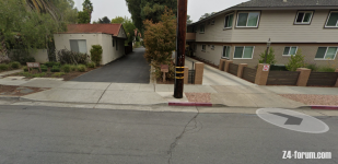

The worst part of this state is the entrances/exits from parking lots.
These are brutal. That front lip eats so much asphalt going over these.
The previous owners were an older couple and had zip ties to hold the lower bumper grille in place. I now understand their reason, it's inevitable to knock that loose...
Thankfully that's the only exterior blemish this car came with; the bumper had plenty of gouges so I don't feel bad contributing to the collection haha. Coming in at an angle helps, but not a perfect solution. I've just accepted this; mountain roads make up for the pain of hearing a scrape now and then.
