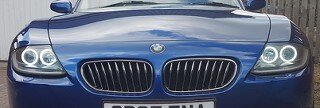

here is my car: A68D07E7-C1FA-4666-9810-1CEC82CEFF24.jpg
You could go hard and do your own angels ie. splitting open the headlights and wiring up your own led halo rings which you can buy from ebay or various online shops. There are plenty of tutorials on here, and you can then go as bright as the ones in my sig during daylight. You just need to fight the fear! :-o
Or I'm sure someone can give you some advice on changing the bulbs for the ones you already have. It depends how dramatic of an effect you want. Probably start with option 2 and keep option 1 in mind for the future.

omg, that's really interesting. i don't even think about this.
also, here i find interesting thing: http://www.z4-forum.com/forum/viewtopic.php?f=27&t=36896
20W lamps and DRL must be more visible in daytime. cool. i try it tomorrow. last question in this theme: must i take out front bumper to take out angel eye lamp ? or i can do it with just opened hood? in my old cars like Opel Astra GTC H i can take lamps without taking out bumper and it's save me a lot of time.
i think we done this with easy way. i buy new 20W lamps and code DRL with computer. thank guys.

Assuming you already have Angel eyes - this thread speaks about increasing the wattage of the bulb. I'm sure you could find an LED equivalent on eBay?!
thanks ! i think i buy lamp with more power, at first. and if this not works good for me - i can take LED.
You should be able to access the bulb from the back of the headlight. Turn your steering wheel full lock so your front wheel is facing inward towards the car. Beneath the front arch should be a square cover. Remove the cover and you can access the back of the headlight.
