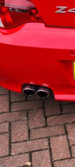

Finally got round to having the back box modified to a quad system, rather than a T-off the guy got a custom box with two inlets and two outlets giving pretty close to equal gas flow through the system. Its just a little louder than stock with a nice gurgle when it's revved too :driving: hopefully get a bit more noise once its settled :thumbsup: no drone at all however so reluctant to whip out the central resonator. The guy said he hopes it's the last one he ever has to do as the right pipe kicked his a*** :rofl: received_2328246717469699.jpegreceived_687641348468771.jpegreceived_676228022943274.jpeg20200526_135704.jpg

It was done at simons custom exhausts in east kilbride for the hefty sum of £520, he had done a forum car previously, can't remember the username but he welded two backboxes together for equal gas flow, this time he used a single box with two inlets and two outlets giving the same effect.
His previous experience urged me to have him do it, in hindsight I would have waited for my dad's work to open back up and get a full system for about the same, but i had itchy feet :roll:
