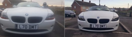

Thats a mighty fine job you've done there m8 . Im not for opening them up so reason i will just stick a bulb in and not wire it up.

Don't you just love the cameras in phones nowadays , flipping great
