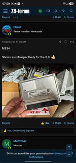

I’ve only got later si ones at the moment
