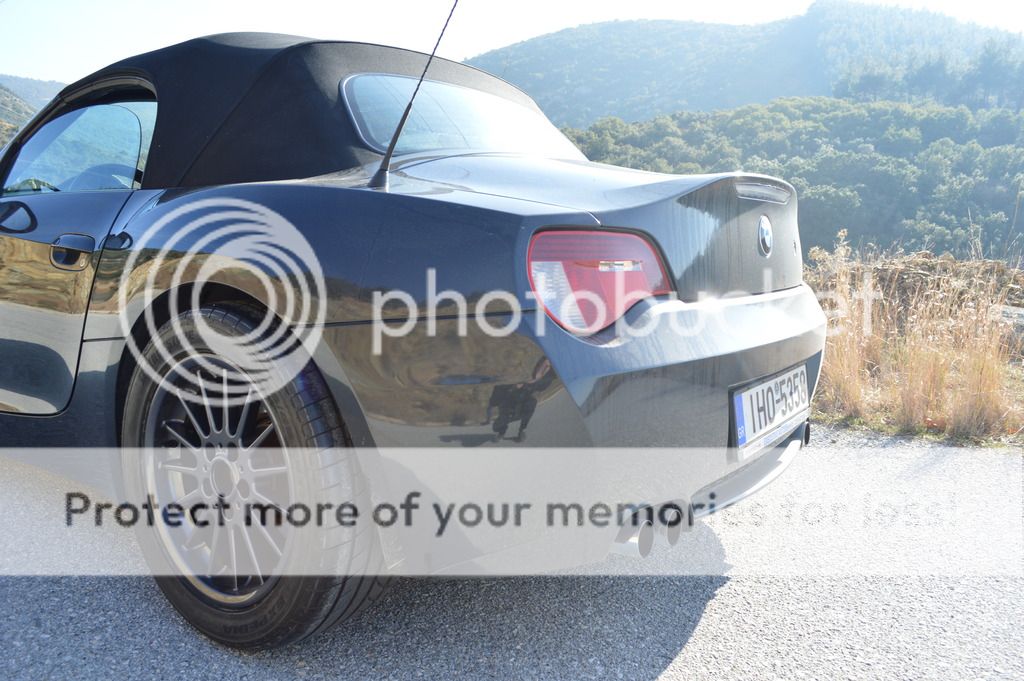

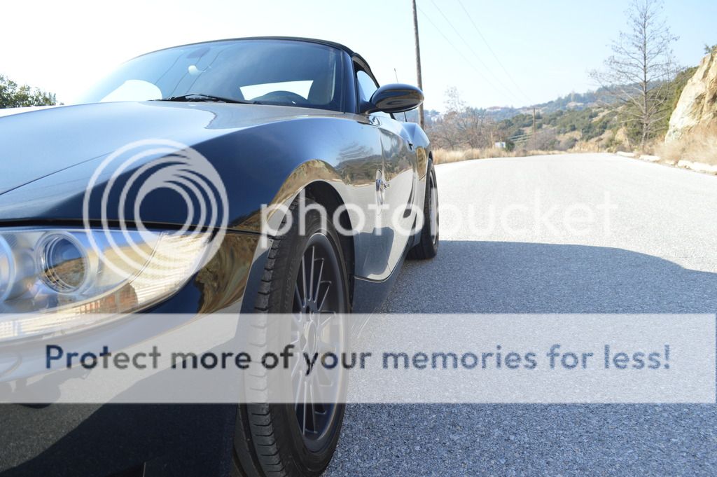

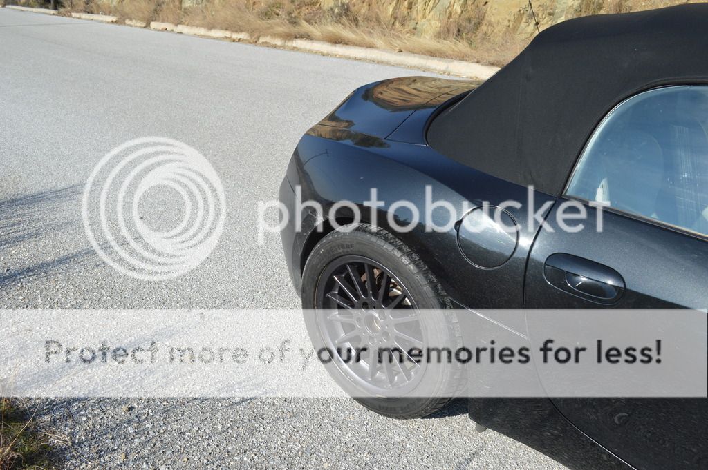

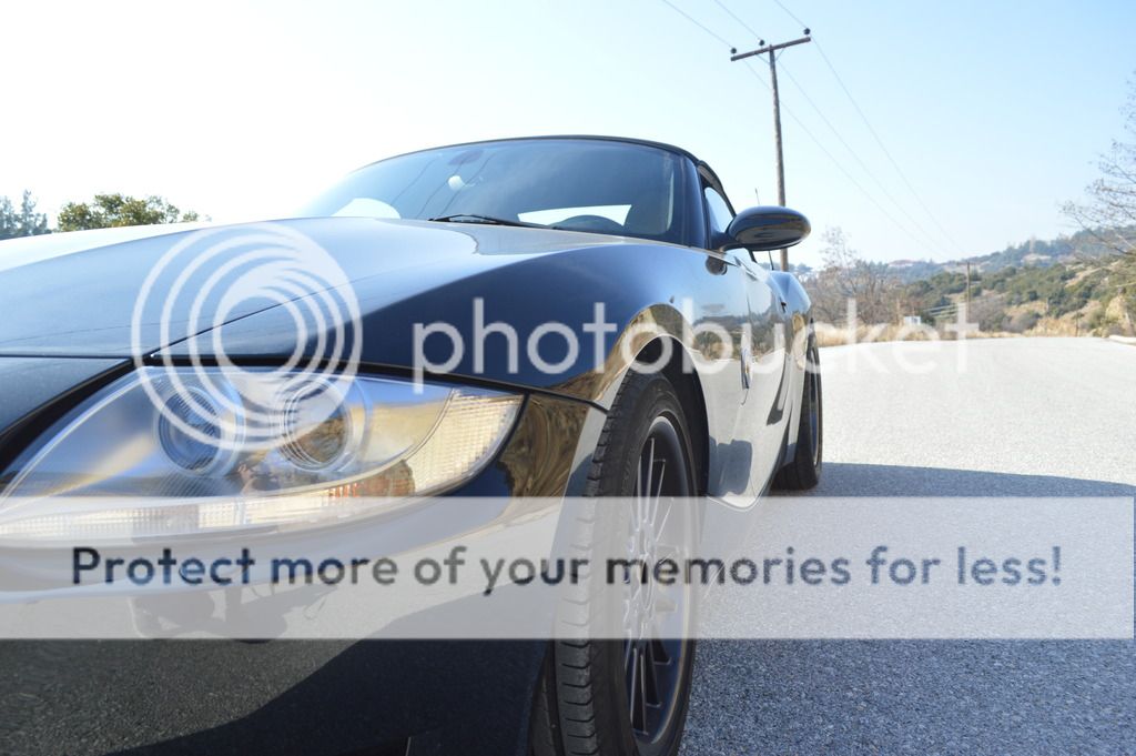

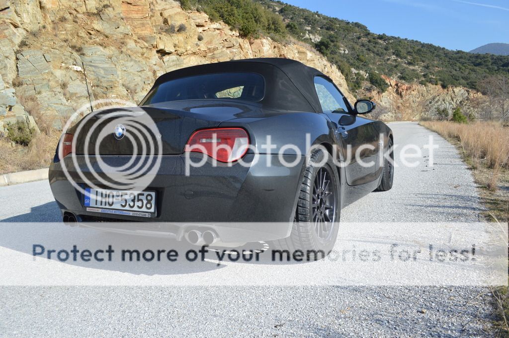

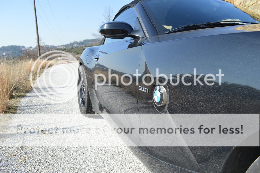

So I'm currently on 225/45 front and 255/45 rear. Below the results.
