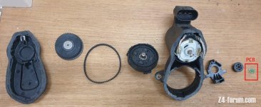

Unfortunately, the error code/message does not indicate which of these two motors is defective. I bought a used one on eBay so I could test it by trial and error: there is a 50% chance of identifying the faulty EMF motor on the first try. Replace it with the spare part and check if the error is resolved. If not, the 2nd EMF motor must be replaced with the 1st EMF motor that has just been dismantled.
The defective motor was cut open:
The whole story:

RobbiZ4 said:
Aside from the known software bug, as @flybobbie said, the temperature sensors in the EMF motors can suffer from corrosion.
Good to know..the motors can be picked up pretty cheap new anyway..non OE
Inside of my cars faulty unit.
I think if approaching 100k miles treat as something that needs replacing, cheap enough.
Same time i replaced the cylinder seals. I think some brake fluid and water leaked into motor.
