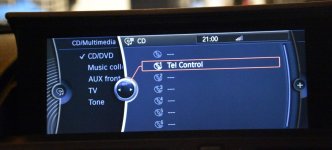

There's now two new menus on the iDrive: CD/Multimedia and Telephone. This was done by coding remotely, I'm not sure what software was used to do this.
Once the phone is paired, CD1 shows "Tel Control."

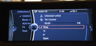

Selecting "Tel Control" takes you to the track info/controls. Next track, Previous track, Stop, Start and Random play (visible on a second screen once the 'options' button on the iDrive is pressed, or the iDrive selector is pressed to the right) are available.
