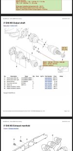

Wassup said:Just a note on torque settings, the driveshaft bolts are 100nm on our cars as its the steel torx bolts not the silver torx bolts found on the very earliest E46 m3.
jontZ4M said:Wassup said:Just a note on torque settings, the driveshaft bolts are 100nm on our cars as its the steel torx bolts not the silver torx bolts found on the very earliest E46 m3.
I knew posting these vids would be useful! Thanks a lot.
OK so my prop bolts are 10NM too tight, I guess that's OK. I'll increase the driveshaft bolts to 100NM.
My driveshaft bolts are actually a dark green, I guess that's what BMW call black?
It's weird that we have to get our info from M3 diagrams, I wonder why there isn't Z4M info out there? I checked RealOEM for Z4M but nothing useful.
Wassup said:Fortunately for us, the rear axle is almost identical to the E46 m3 with two exceptions, first being the differential heat sink and secondly the radius arm which uses a different bracket to secure the rear brake flexible hose.
Wassup said:Great effort on the diff
Justino said:Be careful using the E46 torque settings from the realoem diagram, I am sure most are the same, but having finally got TIS working, I noticed a difference on the rear caliper slide pin torque on TIS to what is shown on the exploded realoem pictures.
