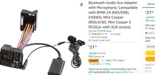

Hi vcn5, thanks for the quick reply! Do you mind sharing the link for the product? I cant seem to find it, basing on what i´ve seen (what the adapters look like) in the youtube videos on how to install them. Any other information regarding this wil be greatly appreciated. Sorry for the trouble!
AMAZON
Seller: Totmox
Bluetooth Audio Aux Adapter with Microphone, Compatible with BMW Z4 (E85/E86), X3(E83), Mini Cooper (R50/JCW), Mini Cooper S R53(Car with AUX access)
See attachment
