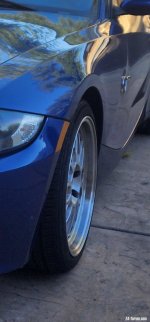

plenty said:225s will fit on an 8.5 inch rim but will be heavily stretched and not advisable.
Well, I'm speaking from experience as I once bought a set of 225s (Goodyear Assymmetric 3s) on 8.5 Rotas that were stretched like goatse. Although I drove on those pretty hard and they didn't cause me any trouble.feket663 said:plenty said:225s will fit on an 8.5 inch rim but will be heavily stretched and not advisable.
I don't think an 1/2 inch (12,5 mm) wider rim cause "heavy stretched" tyres.
plenty said:Well, I'm speaking from experience as I once bought a set of 225s (Goodyear Assymmetric 3s) on 8.5 Rotas that were stretched like goatse. Although I drove on those pretty hard and they didn't cause me any trouble.feket663 said:plenty said:225s will fit on an 8.5 inch rim but will be heavily stretched and not advisable.
The ideal tyre width for 8-inch rims is 235. Most 225s will be a slight stretch even on 8s. It does vary by tyre make - some 225s are wider than others.
