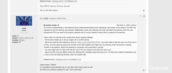

It could be a problem with the pre-load on the rack itself.
  • Screenshot 2025-06-04 at 10-03-44 (3) E85_E86 Steering Problems (Solved) - Page 31 - Z4-forum....png
