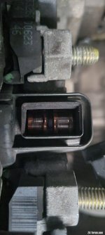

One last thing I replaced my alternator because the slip rings were heavily worn if yours look like this then I recommend a new alternator or getting yours rebuilt as suggested by colb.
One last thing If your
