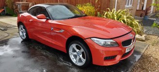

Good afternoon all!
So to cut a very long story short... I have a 2.0i sdrive and my N20B20A engine died on me.... Thrust bearing failed... Crankshaft drilled a nice wee hole in my case as the engine went bang :!:
I've now managed to acquire a 2.3i (2.5l straight 6) and plan on putting the engine from that into my 2.0i shell...
Thoughts and advice welcome, I'm a total noob on this sort of thing but competent enough to follow instructions :D
Is it possible, what do I need to consider when making the transplant! If I go ahead with it I'll document fully my steps for future generations! Haha
Cheers!
David

Haha! I've bought the whole car! Probably should have been a bit clearer
A nice wee Valencia orange with a gloss black roof but no engine!
And another with a working engine but "slightly" bashed!
