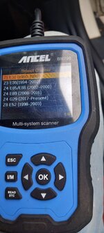

Check the actual roof loom with the wiring and pipes for cracks and perishing. Always do a scan; the electronics in a Z4 are complicated, and it may have some faults. You need a model-specific reader, not a generic one.
Any suggestions for a reader?
Thanks for the info
