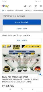

When I got my car I had the front wishbones and lollipops changed to Meyle HD which is the Wishbones, Lollipops and bushes ready to be fitted. Probably around £200 for the parts. Then changed the tyres and had a Hunter alignment done. Was like driving a new car.
All the bushes on the Z4 need replaced at some point. Best to get it looked at to see what actually needs replaced then look at acrylic bushes Powerflex do them all, purple ones will be enough. Either change all of them on the car at once or start at the front and work back.
