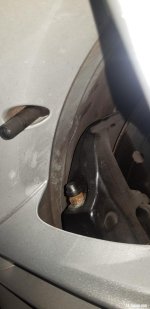

Look at the second pic down, I can't see how the outer edge of front tyre won't foul the arch liner on any spirited driving that involves a bend & even reasonable speed , throw in some compression & it's goodnight Vienna for the liners.
245 on front would help
Yes good point, I certainly don't want that. I had hoped that the reduction in overall diameter would have helped to prevent this.

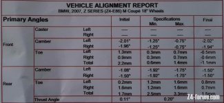

For alignment, I always go with toe out on the front for that crisp turn in and I have to say with cup 2 tyres, it is next level! Rear camber is 1.50 thanks to a set of ECS camber arms with a small amount of toe in as straight line high speed stability is compromised a bit with toe out on the front.

Front track 1535mm & rear is 1519mm without spacers. Might leave it without rear spacers to leave the offset as the turn in is awesome but does highlight the limits of the Bilstein B12 suspension it has. When rapidly changing direction, roll is noticeable so an H&R anti roll bar kit & KW V3 will have to be the next mods!
Yep I have been using it for track work for the past couple of years, very simple modifications (B12, BBK with RSL29, vibra technics mounts, Gruppe M, RTAB limiters, ECS rear camber arms) so far as mods are expensive and preventative maintenance must come first! I found that sorting out the spring rates and fixing the geometry yielded the biggest benefits, standard geometry is set-up for understeer from my experience.
