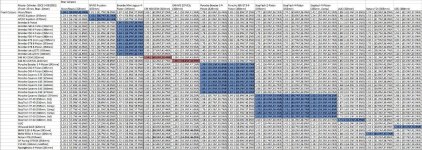

Correct, although the caliper is bigger and there are 3 pairs of pistons, the overall piston bore area is slightly less than stock, meaning that the bias will shift rearward. My calculations put it at 54.5% front bias (vs 58% stock). Like I said though, this is corrected somewhat by using a more aggressive compound on the front.

Useful chart here, though I'm not certain that our master cylinder is the same as the later m3s using the mk60.
https://thebuildjournal.com/tech-guides/brake-bias-chart-e46-m3/

Indeed, I'm very familiar with that table and have my own spreadsheets I used for calculating Z4M braking options ;)
The Z4M master cylinder is the same as Mk60 M3 and CSL: https://www.realoem.com/bmw/enUS/part?id=BT92-EUR-03-2006-E85-BMW-Z4_M32&mg=34&sg=25&diagId=34_1529&q=34317838638
