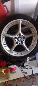

You are a brave man! Not an easy task, so far I have refurbished two wheels and just painted the mating surfaces. Tyres were placed and there was no problem with balancing. Any problem would have shown up then I think. The picture is of a factory-painted insert.
I used a normal spray can paint, titanium silver for the insert, and a darker colour for the rim, As I said, with the tyres fitted it was possible to balance the wheel. The fitter said both rims ran true before the tyres were fitted.
All the surfaces would be painted as one, raw aluminium would corrode and weld them together otherwise. As long as all the old paint is removed and one layer is there shouldn't be too thick. I'd be concerned that "normal" spray paint wouldn't last long. Did you etch prime first to create a bond?

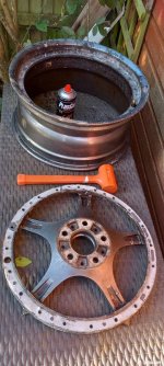

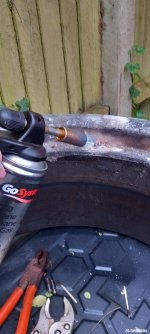

Two rims have been sandblasted and then painted with etch primer before a final coat. I avoided putting multiple layers on the fitting surface and placed bolts in the holes to stop paint from going down them. The other two I intend to be chemically stripped but it is a very time-consuming process. Four broken bolts on one rim were a real challenge. You can see the layer of paint and corrosion on the centre section. But the dead blow hammer was a revelation!

Thank you for pictures as they look very much like mine once split, with mallet and block of wood! That white layer on the star rim was what I was concerned about but seems to be lifting OK.
